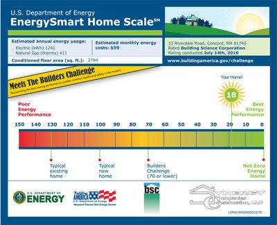

The house is designed to achieve an 87% reduction in source energy use when compared to the 2009 Building America Benchmark. This design features high-R walls, roof, and foundation along with a high efficiency mechanical system. Supplementing the high performance enclosure and mechanical system is a 7 kW PV array installed on the south facing roof. This 87% energy use reduction is equal to HERS 18 and a $4,700 annual utility bill savings to the homeowner.

Estimated Annual Energy Savings: $4,700 per year (87% energy use reduction compared to the Building America Benchmark)

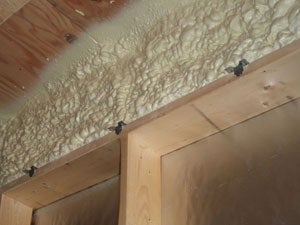

In order to go above and beyond the goal of a 50% energy savings when compared to the Building America Benchmark, exceptional airtightness was specified. And in order to achieve this level of airtightness, multiple methods of air sealing were detailed in the drawings. These methods included the Airtight Drywall Approach for walls and ceilings, high density spray foam at rim joists, backer rod and sealant at windows and doors and taping the XPS insulation joints on the basement walls. For additional airtightness, the builder chose to also tape the foil-faced polyisocyanurate installed on the exterior walls. The actual tested airtightness (0.07 leak ratio) is represented in the parametric chart.

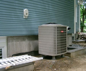

A highlight of the mechanical system design is the dual fuel heating system which includes both a heat pump as well as a high efficiency gas furnace. During the heating season, the heat pump is more efficient at milder outdoor temperatures while the furnace is more efficient at lower, colder outdoor temperatures.

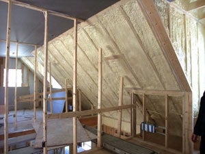

Roof Assembly: Vented attic framed with engineered roof rafters at 24” o.c. over main house: R-60 cellulose at south side ceiling, R-63 at north side cathedralized ceiling (2” foil-faced polyisocyanurate rigid insulation between rafters and 7½” high density 2.0 pcf closed cell spray foam); unvented attic framed with dimensional roof rafters at 24” o.c. over breakfast area and dormers: R-63 high density 2.0 pcf closed cell spray foam.

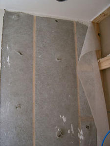

Wall Assembly: 2x6 wood stud walls at 24” o.c. with R-45 wall insulation: cellulose (R-19), 4” foil-faced polyisocyanurate insulating sheathing (R-26), ¾” furring strips and fiber cement siding installed on exterior, ½” drywall installed on interior.
2x6 @ 24" o.c. framing with cellulose insulation

Air Sealing: Maximum 0.15 CFM50 per ft2 of enclosure area. Spray foam at rim joist and breakfast area and dormer roofs, airtight drywall approach used in wall assembly, taped XPS insulation on basement walls. Adhesives and sealants used between framing members, around windows and doors, and at all mechanical and electrical penetrations through the enclosure.

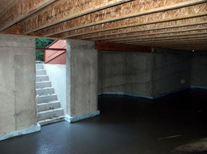

Foundation Assembly: 2” XPS (R-10) and stud wall with fiberglass batt insulation (R-12) installed on wall, 2” XPS (R-10) installed below slab.

Heating and Cooling: 95% AFUE gas furnace and 3-ton 8.2 HSPF/15.5 SEER heat pump split system with hybrid heat.

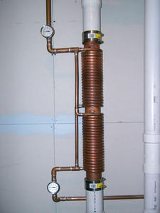

DHW: 0.94 EF gas condensing tankless water heater with drainwater heat recovery.

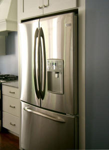

Appliances: All ENERGY STAR® appliances

Concord Cape performance testing was done at both the rough-in stage as well as after construction was complete. At the time of the rough-in testing, the following had been installed: all windows and doors, high density spray foam at rim joists and unvented roofs (breakfast area and dormers), second floor ceiling drywall, taped exterior insulation, sheet metal ductwork and mechanical equipment in the basement. The blower door test result was 1019 CFM50, which is equal to 0.13 CFM50 per ft2 of enclosure area and 1.44 ACH50. Even before the Airtight Drywall Approach was implemented on the walls, the Concord Cape met the specified airtightness. Final performance testing revealed an even more airtight house with the following blower door test results: 505 CFM50, equal to 0.07 CFM50 per ft2 of enclosure area and 0.72 ACH50. Duct leakage to outside was measured at 18 CFM25.
