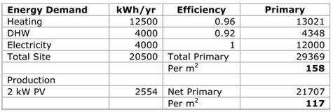

Energy Consumption Compared
Measurements (not the Building America Benchmark assumptions) show that electricity use for appliances and miscellaneous loads can be held to 3000-4000 kWh/year per household in a modest sized, typical home. This can be reduced further by very efficient appliances, exceptional lighting, and by better controls. The reported values for Passivhauses tend to be lower, in the range of 2500 to 3000 kWh/year. These lower levels can be achieved in North American homes, but depend on occupants operating and maintaining the home in a low energy manner.
Domestic hotwater energy consumption is approximately 3000 - 4000 kWh/year per household in American homes.3 Large variations depend on the lifestyle of the occupants, but this energy use appears to be similar in Passivhauses. If a basement is available, this energy use can be reduced (perhaps by 10-20%) by drainwater heat recovery and reduced (perhaps by 10-20%) by choosing the very lowest hot water use appliances. Again, occupant behavior is critical: a retired couple may use half this energy, whereas a family of five with teenage children can use 50% more. A reasonably priced two-panel flat-plate solar hot water system can provide about 2000 kWh/yr of preheated water to the domestic hot water appliances even in cold climates.
Space conditioning and ventilation energy demand for houses built to the low energy standard described above in DOE Climate Zones 5-7 tends to be 10000 to 15000 kWhe for a house with 2000 ft2 living space (54 to 80 kWhe/m2/yr). An upgrade from double to triple-glazed windows (R-3.3 to R-5 or R-6), and the addition of an efficient HRV drops these values by 2000-3000 kWh/yr, and if a south-facing exposed solar lot is available, another 1000-2000 kWh can be reduced. Hence space heating energy values can be reduced to the range of 7000-11000 kWh/yr by some combination of measures that may be available on some lots (full south exposure is often NOT available) and may be cost effective in some situtations (triple-glazed windows are not always cost effective).
Using a site-to-source (site-to-primary energy to use PH terms) conversion of natural gas to electricity of 3 (which is about mid-way between the German 2.7 value and the US Department of Energy gives as a 3.365 value), the following general energy use profile can be developed for a 25 by 40 ft raised ranch home with a fully finished basement (e.g., a home with 2000 ft2 of conditioned, useable space).
The table below takes mid-range values for energy consumption and converts this energy demand to primary (source) energy use. It assumes the smallest available standard condensing natural gas two-stage furnace with an ECM motor (e.g. Goodman GMH95), a condensing sealed-combustion hotwater heater (such as an AO Smith Vertex, Navien, Quietside, or Viessman VitoDens), an efficient HRV (such as a Fantech VHR704 with an AirCycler controller), Energy Star appliances and all CFL lighting.
Table 1: Energy Consumption for a Typical Low-Energy BSC Building America
prototype home
As can be seen, the source energy consumption, at 158 kWh/m2/yr, exceeds the Passivhaus requirement of 120 kWh/m2/yr (because the German method of floor area calculation is different than that used in North America, the whole house comparison is more accurately 29300 vs 17800 kWh). However, for a further unsubsidized investment of under $20000, a 2.5 kW PV array (which can generate 3250 kWh/yr) can be installed that reduces primary energy consumption by 9750 kWh to close in on the arbitrary (and laudable) Passivhaus energy target. The PV was chosen in this case as it was the least cost approach to achieving the target. In many cases triple-glazed windows and ERV (at an upcharge of $4000-5000 these measures may save 2000-3000 kWh/yr) may be a less expensive approach in conjunction with a 2.0 kW array. PV is currently the most expensive un-subsidized form or renewable energy, often at a cost of 50 to 70 cents per kWh. Many renewable and/or no-carbon sources of electricity (such as wind, bio-mass, tidal, etc) can be produced for 1/2 to 1/3 this cost (see also BSI-026: Passivhaus Gets Active).
Some of the PH recommendations require designers to spend more limited resources on conservation that are even more expensive that producing the energy at the very high bar of current PV prices. For example, in a 6000 HDD F climate, switching from a 0.6 W/cfm, 63% efficient Fantech HRV to a PH-certified 80% efficient, 0.75 W/cfm HRV will, even if one uses the same ASHRAE 62.2 50 cfm ventilation rate, saves $11 per year in heating energy at $1.65/therm gas and 15 cent/kWh prices. Even if gas and electric prices triple in the next ten years, it is not feasible that the $1000-$1200 premium commanded by a PH-certified HRV can ever be recouped.  Upgrading the 200 square feet (10% of floor area served) of R6 windows (such as Inline fiberglass with argon-filled dual low-e coatings) to R-7.1 PH-certified windows (superior performance) might save 250-400 kWh/yr in a 6000 HDD climate, but would command a $10000 premium at current prices. Increasing the R-value of sub-slab insulation from R-20 to R-40 is another measure that is very expensive.
Doubling the insulation levels of the proposed home (i.e., changing the specs to R-10 windows, R-80 walls, R-120 roof, 0.6 ACH@50, and a 100% HRV),) and increasing airtightness would not necessarily reduce primary energy demand enough to meet the PH energy target. Increasing the insulation, window, and airtightness values to these levels is not only quite expensive, but very architecturally constraining, i.e., dormers, bay windows, etc all become challenging to incorporate and maintain low surface-volume ratios. Even with all of the measures to halve the heating energy demand, the primary energy demand intensity would barely drop below 120 kWhe/m2/yr (the PH energy target).
In DOE Climate Zone 6 or 7, the peak heating demand of the extreme R-10/R-80/R-120 specification would remain above the 10W/m2 (3.2 Btu/ft2 or 6400 Btu/hr) PH recommendation without relying on occupant producing average heat (eg not below average, with one person at home) and thermal mass, and 50 cfm of ventilation airflow would not be sufficient to provide space heating on a design 0 °F or -10 °F night (that is, the heat loss would need to be lowered to 3000 Btu/hr for ventilation air to provide heating). As the cost of an efficient furnace (described above) is less than about $2500 installed (plus ductwork, which is largely needed for ventilation anyway), and smaller capacity furnaces cost no less, there are essentially no capital cost savings to reducing space heating energy demands.4
From a point of view of the wise use of capital, the Passivhaus approach in cold-climate zones of North America can lead to more expensive, less architecturally flexible, and even potentially more energy intensive houses than a more flexible approach that focuses only on the least cost, most durable means of achieving a primary energy use per area target value. Perhaps the most important contribution made by the PH standard to low-energy North American housing is that one cannot simply buy $200,000 worth of PV panels to meet the target, as too many net zero homes have done.
