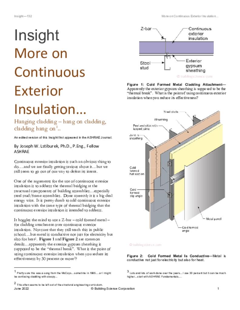

One of the arguments for the use of continuous exterior insulation is to address the thermal bridging at the structural components of building assemblies…especially steel stud/frame assemblies. Done correctly it is a big deal energy wise. It is pretty dumb to add continuous exterior insulation with the same type of thermal bridging that the continuous exterior insulation is intended to address.
It boggles the mind to use a Z-bar – cold formed metal – for cladding attachment over continuous exterior insulation. Not sure that they still teach this in public school….but metal is conductive not just for electricity but also for heat[2].
 Figure 1 and Figure 2 are common details…apparently the exterior gypsum sheathing is supposed to be the “thermal break”.  What is the point of using continuous exterior insulation when you reduce its effectiveness by 30 percent or more[3]?

Figure 1: Cold Formed Metal Cladding AttachmentApparently the exterior gypsum sheathing is supposed to be the “thermal break”. What is the point of using continuous exterior insulation when you reduce its effectiveness?
Figure 2:  Cold Formed Metal Is Conductive—Metal is conductive not just for electricity but also for heat.
