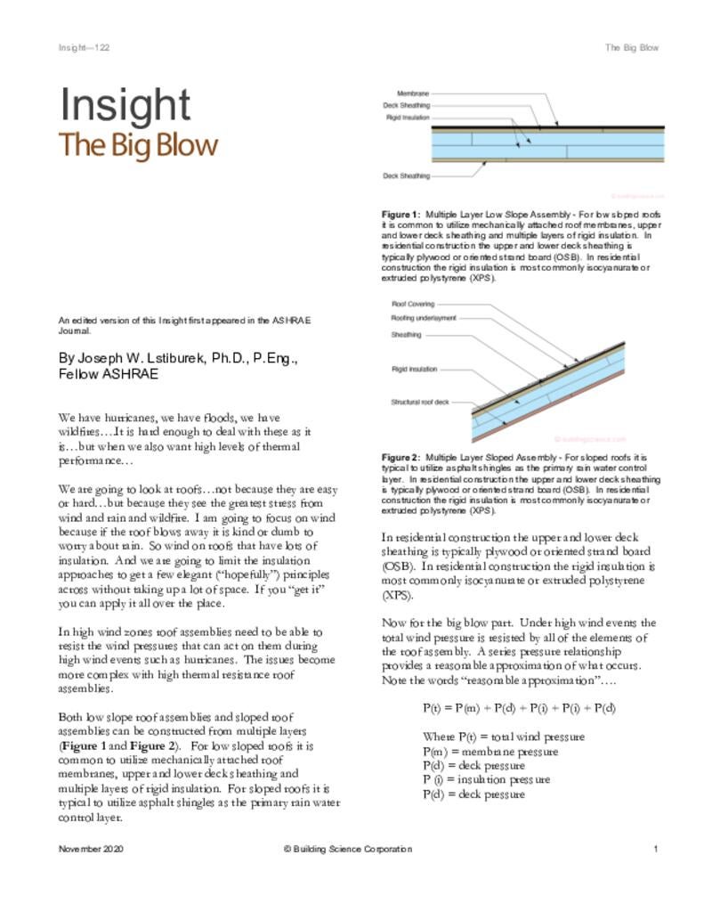

Both low slope roof assemblies and sloped roof assemblies can be constructed from multiple layers (Figure 1 and Figure 2).   For low sloped roofs it is common to utilize mechanically attached roof membranes, upper and lower deck sheathing and multiple layers of rigid insulation.  For sloped roofs it is typical to utilize asphalt shingles as the primary rain water control layer.
Figure 1:  Multiple Layer Low Slope Assembly - For low sloped roofs it is common to utilize mechanically attached roof membranes, upper and lower deck sheathing and multiple layers of rigid insulation.  In residential construction the upper and lower deck sheathing is typically plywood or oriented strand board (OSB).  In residential construction the rigid insulation is most commonly isocyanurate or extruded polystyrene (XPS).
Figure 2:  Multiple Layer Sloped Assembly - For sloped roofs it is typical to utilize asphalt shingles as the primary rain water control layer.  In residential construction the upper and lower deck sheathing is typically plywood or oriented strand board (OSB).  In residential construction the rigid insulation is most commonly isocyanurate or extruded polystyrene (XPS).
Now for the big blow part.  Under high wind events the total wind pressure is resisted by all of the elements of the roof assembly.  A series pressure relationship provides a reasonable approximation of what occurs.  Note the words “reasonable approximation”….
P(t) = P(m) + P(d) + P(i) + P(i) + P(d)
Where P(t) = total wind pressure
P(m) = membrane pressure
P(d) = deck pressure
P (i) = insulation pressure
