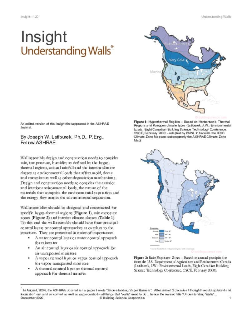

Wall assembly design and construction needs to consider rain, temperature, humidity as defined by the hygro-thermal regions, annual rainfall and the interior climate classes as environmental loads that affect mold, decay and corrosion as well as other degradation mechanisms.  Design and construction needs to consider the exterior and interior environmental loads, the nature of the materials that comprise the environmental separation and the energy flow across the environmental separation.
Wall assemblies should be designed and constructed for specific hygro-thermal regions (Figure 1), rain exposure zones (Figure 2) and interior climate classes (Table 1).  To this end the wall assembly should have four principal control layers or control approaches as overlays to the structure.
They are presented in order of importance:
  • A water control layer or water control approach for rainwater
  • An air control layer or air control approach for air transported moisture
  • A vapor control layer or vapor control approach for vapor transported moisture
  • A thermal control layer or thermal control approach for thermal transfer
Figure 1: Hygrothermal Regions – Based on Herbertson’s Thermal Regions and Koeppen climate types (Lstiburek, J.W.; Environmental Loads, Eight Canadian Building Science Technology Conference, CSCE, February 2000 – adapted by PNNL to become the IECC Climate Zone Map and subsequently the ASHRAE Climate Zone Map).
 Figure 2: Rain Exposure Zones – Based on annual precipitation from the U.S. Department of Agriculture and Environment Canada (Lstiburek, J.W.; Environmental Loads, Eight Canadian Building Science Technology Conference, CSCE, February 2000).
Table 1: Interior Climate Classes (Lstiburek, J.W.; Environmental Loads, Eight Canadian Building Science Technology Conference, CSCE, February 2000).
