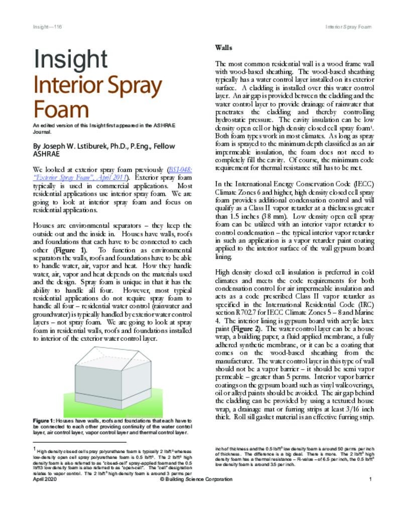

We looked at exterior spray foam previously (BSI-048: “Exterior Spray Foam”, April 2011). Exterior spray foam typically is used in commercial applications.  Most residential applications use interior spray foam.  We are going to look at interior spray foam and focus on residential applications.
Houses are environmental separators – they keep the outside out and the inside in.  Houses have walls, roofs and foundations that each have to be connected to each other (Figure 1).  To function as environmental separators the walls, roofs and foundations have to be able to handle water, air, vapor and heat. How they handle water, air, vapor and heat depends on the materials used and the design.  Spray foam is unique in that it has the ability to handle all four.  However, most typical residential applications do not require spray foam to handle all four – residential water control (rainwater and groundwater) is typically handled by exterior water control layers – not spray foam.  We are going to look at spray foam in residential walls, roofs and foundations installed to interior of the exterior water control layer.
Figure 1: Houses have walls, roofs and foundations that each have to be connected to each other providing continuity of the water control layer, air control layer, vapor control layer and thermal control layer.
Walls
The most common residential wall is a wood frame wall with wood-based sheathing.  The wood-based sheathing typically has a water control layer installed on its exterior surface.  A cladding is installed over this water control layer. An air gap is provided between the cladding and the water control layer to provide drainage of rainwater that penetrates the cladding and thereby controlling hydrostatic pressure.  The cavity insulation can be low density open cell or high density closed cell spray foam[1].  Both foam types work in most climates.  As long as spray foam is sprayed to the minimum depth classified as an air impermeable insulation, the foam does not need to completely fill the cavity.  Of course, the minimum code requirement for thermal resistance still has to be met.
In the International Energy Conservation Code (IECC) Climate Zones 6 and higher, high density closed cell spray foam provides additional condensation control and will qualify as a Class II vapor retarder at a thickness greater than 1.5 inches (38 mm). Low density open cell spray foam can be utilized with an interior vapor retarder to control condensation – the typical interior vapor retarder in such an application is a vapor retarder paint coating applied to the interior surface of the wall gypsum board lining.
High density closed cell insulation is preferred in cold climates and meets the code requirements for both condensation control for air impermeable insulation and acts as a code prescribed Class II vapor retarder as specified in the International Residential Code (IRC) section R702.7 for IECC Climate Zones 5 – 8 and Marine 4.  The interior lining is gypsum board with acrylic latex paint (Figure 2). The water control layer can be a house wrap, a building paper, a fluid applied membrane, a fully adhered synthetic membrane, or it can be a coating that comes on the wood-based sheathing from the manufacturer.  The water control layer in this type of wall should not be a vapor barrier – it should be semi vapor permeable – greater than 5 perms.  Interior vapor barrier coatings on the gypsum board such as vinyl wallcoverings, oil or alkyd paints should be avoided.  The air gap behind the cladding can be provided by using a textured house wrap, a drainage mat or furring strips at least 3/16 inch thick. Roll sill gasket material is an effective furring strip.
