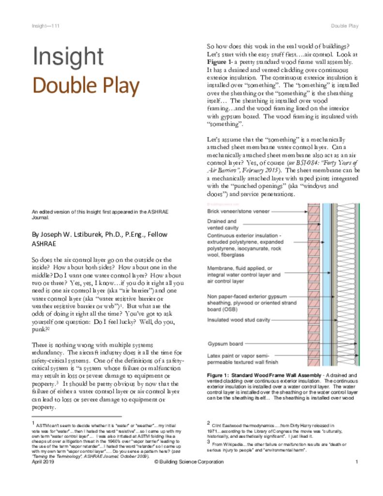

So how does this work in the real world of buildings?  Let’s start with the easy stuff first….air control.  Look at Figure 1- a pretty standard wood frame wall assembly.  It has a drained and vented cladding over continuous exterior insulation.  The continuous exterior insulation is installed over “something”.  The “something” is installed over the sheathing or the “something” is the sheathing itself…  The sheathing is installed over wood framing…and the wood framing lined on the interior with gypsum board.  The wood framing is insulated with “something”.
Figure 1:  Standard Wood Frame Wall Assembly- A drained and vented cladding over continuous exterior insulation. The continuous exterior insulation is installed over a water control layer.  The water control layer is installed over the sheathing or the water control layer can be the sheathing itself…  The sheathing is installed over wood framing…and the wood framing lined on the interior with gypsum board.  The wood framing cavity is insulated.
