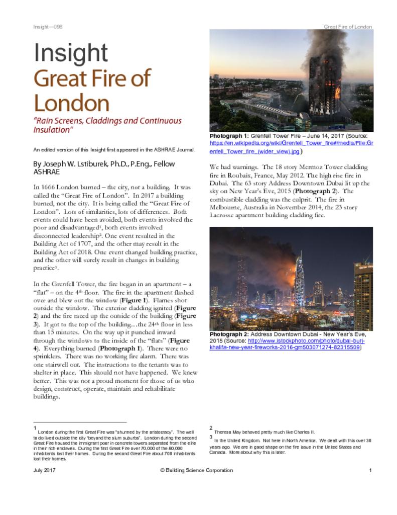

BSI-098: Great Fire of London
In the Grenfell Tower, the fire began in an apartment – a “flat” – on the 4th floor. The fire in the apartment flashed over and blew out the window (Figure 1). Flames shot outside the window. The exterior cladding ignited (Figure 2) and the fire raced up the outside of the building (Figure 3). It got to the top of the building…the 24th floor in less than 15 minutes. On the way up it punched inward through the windows to the inside of the “flats” (Figure 4). Everything burned (Photograph 1). There were no sprinklers. There was no working fire alarm. There was one stairwell out. The instructions to the tenants was to shelter in place. This should not have happened. We knew better. This was not a proud moment for those of us who design, construct, operate, maintain and rehabilitate buildings.
We had warnings. The 18 story Mermoz Tower cladding fire in Roubaix, France, May 2012. The high rise fire in Dubai. The 63 story Address Downtown Dubai lit up the sky on New Year’s Eve, 2015 (Photograph 2). The combustible cladding was the culprit. The fire in Melbourne, Australia in November 2014, the 23 story Lacrosse apartment building cladding fire.
Photograph 1: Grenfell Tower Fire – June 14, 2017 (Source: https://en.wikipedia.org/wiki/Grenfell_Tower_fire#/media/File:Grenfell_Tower_fire_(wider_view).jpg)
Photograph 2: Address Downtown Dubai - New Year’s Eve, 2015 (Source: http://www.istockphoto.com/photo/dubai-burj-khalifa-new-year-fireworks-2016-gm503071274-82315509)
Figure 1: Fire Blows Out Window Figure 2: Cladding Ignites – Insulation In Cavity Ignites
Figure 3: Fire Propagates Vertically and Horizontally Figure 4: Fire Punches Inward Through Windows To Inside
