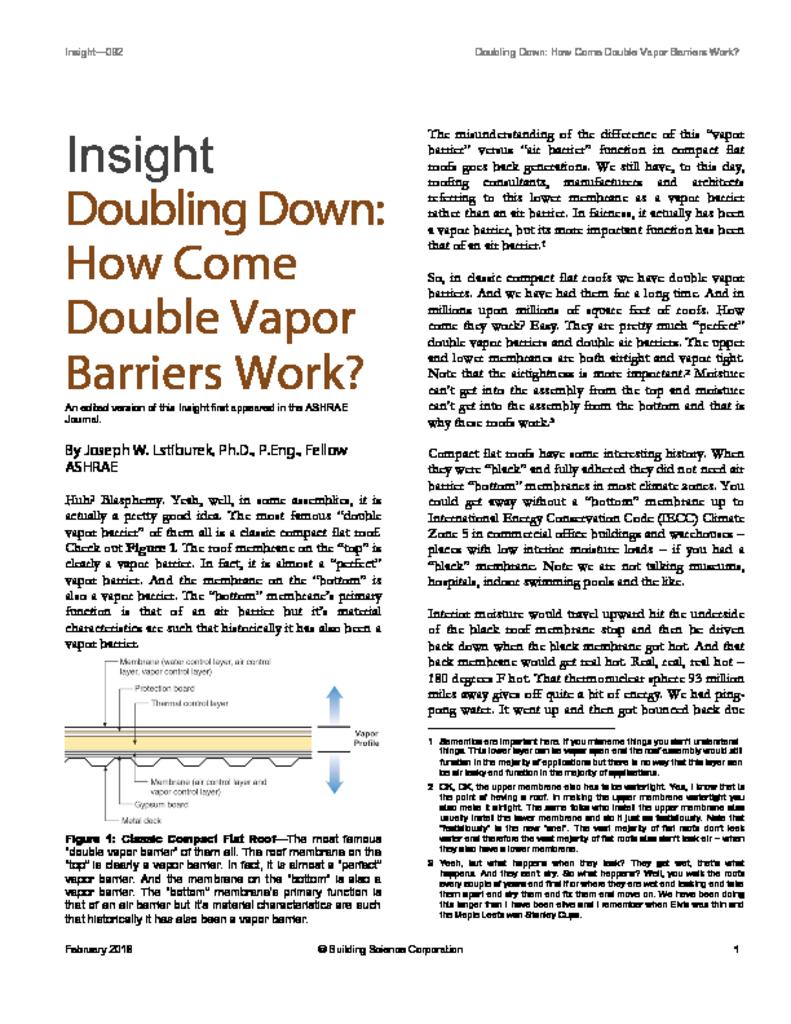

Huh? Blasphemy. Yeah, well, in some assemblies, it is actually a pretty good idea. The most famous "double vapor barrier" of them all is a classic compact flat roof. Check out Figure 1. The roof membrane on the "top" is clearly a vapor barrier. In fact, it is almost a "perfect" vapor barrier. And the membrane on the "bottom" is also a vapor barrier. The "bottom" membrane's primary function is that of an air barrier but it's material characteristics are such that historically it has also been a vapor barrier.
Figure 1: Classic Compact Flat Roof—The most famous "double vapor barrier" of them all. The roof membrane on the "top" is clearly a vapor barrier. In fact, it is almost a "perfect" vapor barrier. And the membrane on the "bottom" is also a vapor barrier. The "bottom" membrane's primary function is that of an air barrier but it's material characteristics are such that historically it has also been a vapor barrier.
The misunderstanding of the difference of this "vapor barrier" versus "air barrier" function in compact flat roofs goes back generations. We still have, to this day, roofing consultants, manufacturers and architects referring to this lower membrane as a vapor barrier rather than an air barrier. In fairness, it actually has been a vapor barrier, but its more important function has been that of an air barrier.1
So, in classic compact flat roofs we have double vapor barriers. And we have had them for a long time. And in millions upon millions of square feet of roofs. How come they work? Easy. They are pretty much "perfect" double vapor barriers and double air barriers. The upper and lower membranes are both airtight and vapor tight. Note that the airtightness is more important.2 Moisture can't get into the assembly from the top and moisture can't get into the assembly from the bottom and that is why these roofs work.3
Compact flat roofs have some interesting history. When they were "black" and fully adhered they did not need air barrier "bottom" membranes in most climate zones. You could get away without a "bottom" membrane up to International Energy Conservation Code (IECC) Climate Zone 5 in commercial office buildings and warehouses – places with low interior moisture loads – if you had a "black" membrane. Note we are not talking museums, hospitals, indoor swimming pools and the like.
Interior moisture would travel upward hit the underside of the black roof membrane stop and then be driven back down when the black membrane got hot. And that back membrane would get real hot. Real, real, real hot – 180 degrees F hot. That thermonuclear sphere 93 million miles away gives off quite a bit of energy. We had pingpong water. It went up and then got bounced back due to solar radiation. Life was easy. Then membranes became “white”. They didn’t get so hot. White membranes were “cool” – 120 degrees F cool. The interior moisture that traveled upwards didn’t get bounced back as much and we began to have problems even in office buildings and warehouse roof assemblies. We now needed air barriers. We put them in and the problems disappeared. Note that these air barriers were almost always vapor barriers.

So lets go back to Figure 1. The “vapor profile” clearly is one of a “double vapor barrier” and it works. It works fabulously well and has done so for a very, very long time in all the climate zones. So much for the “common wisdom” of never having “double vapor barriers”. Yeah, but roofs don’t count4. What about walls?
