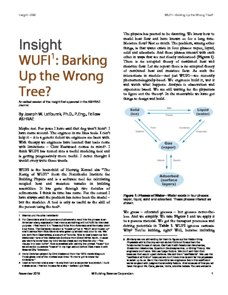

BSI-089: WUFI*—Barking Up the Wrong Tree?
Maybe not. For years I have said that dog won’t hunt1. I have come around. The engineer in me likes tools. I can’t help it – it is a genetic defect we engineers are born with. With therapy we engineers have learned that tools come with limitations – Clint Eastwood comes to mind2. I think WUFI has turned into a useful modeling tool and is getting progressively more useful. I never thought I would ever write those words.
WUFI is the brainchild of Hartwig Kunzel aka “The Konig of WUFI” from the Fraunhofer Institute for Building Physics and is a software tool for calculating coupled heat and moisture transfer in building assemblies. It has gone through two decades of refinements. I think its time has come. For the record I have always said the problem has never been the model – but the modeler. A tool is only as useful as the skill of the person using the tool3.
The physics has proved to be daunting. We know how to model heat flow and have known so for a long time. Moisture flow? Not so much. The problem, among other things, is that water exists in four phases: vapor, liquid, solid and adsorbate. And these phases interact with each other in ways that are not clearly understood (Figure 1). There is no accepted theory of combined heat and moisture flow. Let me repeat: there is no accepted theory of combined heat and moisture flow. As such the interactions in models—not just WUFI—are currently phenomenologically-based. We engineers build it, wet it and watch what happens. Analysis is observation and experience based. We are still waiting for the physicists to figure out the theory4. In the meanwhile we have got things to design and build.
Figure 1: Phases of Water—Water exists in four phases: vapor, liquid, solid and adsorbed.
These phases interact as shown.
We guess – educated guesses – but guesses never-the-less. And we simplify. We take Figure 1 and we apply it to a porous material. We get the transport processes and driving potentials in Table 1. WUFI ignores osmosis. Why? You're kidding righ? Well, because including osmosis interactions makes things way too complicated. Go back and check out “BSI-047: Thick as a Brick” and “BSI-045: Double Rubble Toil and Trouble”. Why porous materials? Non-porous materials are easy to figure out. You don’t need a model for them. They don’t absorb moisture. They don’t get wet – except on the surface. Easy.
