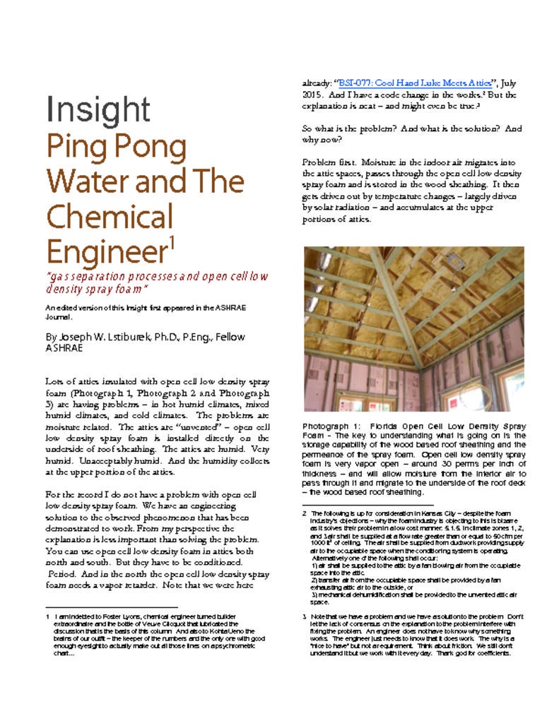

Lots of attics insulated with open cell low density spray foam (Photograph 1, Photograph 2 and Photograph 3) are having problems – in hot humid climates, mixed humid climates, and cold climates.  The problems are moisture related.  The attics are “unvented” – open cell low density spray foam is installed directly on the underside of roof sheathing.  The attics are humid.  Very humid.  Unacceptably humid.  And the humidity collects at the upper portion of the attics.
Photograph 1:  Florida Open Cell Low Density Spray Foam - The key to understanding what is going on is the storage capability of the wood based roof sheathing and the permeance of the spray foam.  Open cell low density spray foam is very vapor open – around 30 perms per inch of thickness – and will allow moisture from the interior air to pass through it and migrate to the underside of the roof deck – the wood based roof sheathing.
Photograph 2:  More Open Cell Low Density Spray Foam - Moisture in the indoor air migrates into the attic spaces, passes through the open cell low density spray foam and is stored in the wood based roof sheathing.  It then gets driven out by temperature changes – largely driven by solar radiation – and accumulates at the upper portions of attics.
Photograph 3: Cold Climate Open Cell Low Density Spray Foam - “Leaky ductwork” did not solve the problem in cold climates with no attic ductwork.  Only vapor retarder coatings coupled with some form of air change via a fan solved the problem in cold climates.  The code requires a vapor retarder on open cell low density spray foam in IECC Climate Zones 5 and higher – but it is typically ignored by installers – and shame on them.  And the manufacturers do not police the installers – and shame on them too.  And the building officials that let them get away with it.  Where is Aretha Franklin when you need her….”shame, shame, shame….”
For the record I do not have a problem with open cell low density spray foam.  We have an engineering solution to the observed phenomenon that has been demonstrated to work. From my perspective the explanation is less important than solving the problem. You can use open cell low density foam in attics both north and south.  But they have to be conditioned.  Period.  And in the north the open cell low density spray foam needs a vapor retarder.  Note that we were here already: “Cool Hand Luke Meets Attics” ASHRAE Journal, April 2014.  And I have a code change in the works.2 But the explanation is neat – and might even be true.3
So what is the problem?  And what is the solution?  And why now?
Problem first.  Moisture in the indoor air migrates into the attic spaces, passes through the open cell low density spray foam and is stored in the wood sheathing.  It then gets driven out by temperature changes – largely driven by solar radiation – and accumulates at the upper portions of attics.
Solution second.  Removing the moisture in the air in the upper portions of attics by “conditioning” the attic with “dehumidified air” or removing the moisture in the air in the upper portions of attics by “air change”.  See footnote on code change.
Why the problem now?  Why did we not have this problem earlier?  See “BSI-077: Cool Hand Luke Meets Attics” July 2015.  Basically, leaky ductwork in unvented attics provided “conditioning”.  Now that we have tighter ducts the conditioning does not happen.  This “leaky ductwork” problem did not solve the problem in cold climates with no attic ductwork.  Only vapor retarder coatings coupled with some form of air change via a fan solved the problem in cold climates.  The code requires a vapor retarder on open cell low density spray foam in IECC Climate Zones 5 and higher – but it is typically ignored by installers – and shame on them.  And the manufacturers do not police the installers – and shame on them too.  And the building officials that let them get away with it.  Where is Aretha Franklin when you need her….“shame, shame, shame….”
