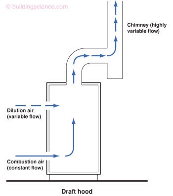

Only one problem. The house had an old oil furnace with an old-fashioned brick-clay chimney on an exterior wall. We got rid of that oil “antique” and replaced it with a new fangled gas furnace. Just vented the gas furnace right into the existing brick chimney.4
 What could go wrong? Well for one thing the furnace needed air to function, especially the chimney part. It was supposed to work like Figure 1. Air from the house would be introduced at two locations to the furnace—as combustion air and as dilution air. Where did this air come from? It was supposed to come from the house. But where did the air in the house come from? Oops. From the outside. But we just got rid of a large number of holes. Also, we had a forced air furnace with ducts and a large fan that blew air all around the place. A supply in every room, a chicken in every pot…but only one return. When bedroom doors were closed the bedrooms would go to a positive air pressure and the common area would go negative. The basement was connected to the common area and had leaky panned floor joists as returns and the basement would also go negative. When the basement would go negative the zone around the furnace would go negative and air would not easily go up the chimney. In fact, air would begin to get pulled down the chimney (Figure 2).
Figure 1: The Right Way
—Air from the house is introduced at two locations to the furnace—as combustion air and as dilution air.
Figure 2: The Wrong WayWhen the basement would go negative the zone around the furnace would go negative and air would not easily go up the chimney. In fact, air would begin to get pulled down the chimney.

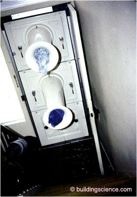

Photograph 3: My Room
—The condensate began to leach through the exterior wall to the interior and damage the plaster. But no one could see it because it was occurring behind a bookcase. This was occurring in my old room. My room. Not my brother’s old room. My room.

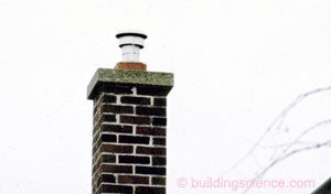

First thing we did was warm up the chimney. We put in a flue liner which reduced the size of the flue and reduced the heat loss through the chimney (Photograph 5). This increased the temperature of the flue gases and the theoretical draft so that should have been the end of it right? Nope. Still had spillage and backdrafting. Couldn’t figure out why until we could measure pressures accurately—down to a Pascal. It was sure nice to be at a university with older engineers running around who knew how to measure things. Once we got the measurements right the “pressure triggers” became obvious. The furnace itself was the culprit. More precisely, the big fan (“blower”) in the furnace did the damage coupled with an unbalanced duct distribution system and leaky returns all inside of what was now a “tight” house. We got the ducts right by making them tight—no more panned floor joists or stud cavities for returns—and then making sure the duct system was fully balanced on the supply and return side. We “invented” transfer grills and jump ducts to balance the pressures and handle the opening and closing of interior doors. All this is old news today, but it sure wasn’t old news in 1982.
Photograph 5: Flue Liner
—Warming the chimney using a flue liner to reduce the size of the flue and reduce the heat loss through the chimney. This increased the temperature of the flue gases and the theoretical draft.

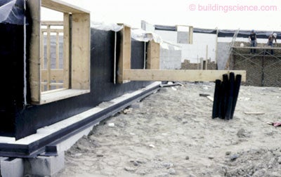

I started to chase BTU’s that didn’t need to be chased. The air in the winter in Canada is cold. Who knew? Maybe I could pull the air through the ground and warm it up before I introduced it to the heat recovery ventilation system. Earth tube preheating. The runs would have to be really long and the ducts would have to be deep—below the frost line—and they would have to be far apart. No problem. I just loved long coiled plastic drainage pipe. I got the “solid” kind and added the “feature” to two houses right away. The first was an enormous custom home (Photograph 6). The second a much smaller house that won me an award (Photograph 7). Got them built and up and running in late fall. The earth tubes worked great through the winter if you believed the temperature measurements I took in the air streams. Man, I was a hero.
Photograph 6: Earth Tubes
—Note the plastic drain pipes sticking out of the ground. Each pipe was 50 feet in length and connected to the intake side of a heat recovery ventilator.

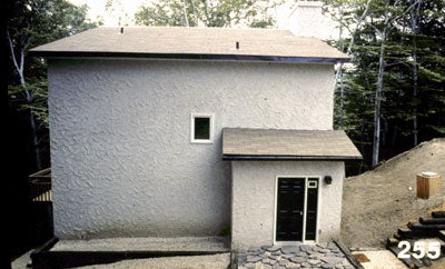

Photograph 7: More Earth Tubes—Note the small wood box off to the side of the house on the hill. That is the intake location for the earth tubes. I got an award for what is probably the ugliest house ever built in Ontario. There is a reason we don’t let engineers do architecture. Yes that is the only window on the north side. No windows on the east and west. Lots of windows on the south.
Then the summer came and the houses began to smell musty and moldy. The smells were coming out of the ventilation system. I chatted with John Timusk and he smiled politely and calmly handed me something called a psychrometric chart. What the heck was this? What a crazy chart. Who does stuff like that? Lines all over the place. Learned to read it. Ouch. The dewpoint temperature of the outside air vapor mix was above the ground temperature for most of the summer. It said so right on the chart. Ouch, again. When I mentioned the “earth tubes” to Gus Handegord (a legend at the Division of Building Research, National Research Council of Canada) he roared with laughter and predicted that I would never get the pysch chart out of my brain for as long as I lived. Yup, I know that chart backwards and forwards and upside down reversed8 to this day.
I ended up disconnecting both systems and capping them. Odor went away. Now when earth tube preconditioning comes up at Passive House conferences and at other “sustainable” and “green” events I tend to smile. Yup. I was that smart once. I politely hand folks a psychrometric chart.

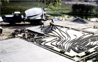

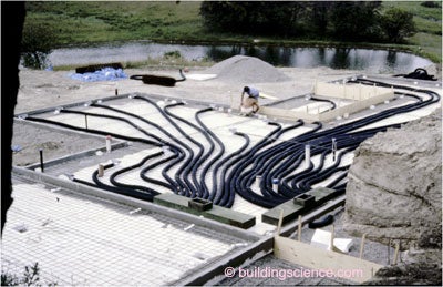

But where to put the ductwork? That’s why God invented basements…a place to put the ductwork. Can’t put the ductwork in the attic. That would be really, really dumb. Easy, put it in the slab. I was already in love with long coiled plastic drainage pipe so the solution was obvious (Photograph 9).
Photograph 9: Ductwork in the Slab
—Long coiled plastic drainage pipe was used for the in slab ductwork. Note the fiberglass reinforced polymer modified cement “gluing” the foam formwork together.
Now comes the fun part. Placing the concrete. It was a Sunday morning. Who works on a Sunday morning placing concrete? Only someone who is behind on the schedule. Placed the concrete for the garage slab first. Easy. No ducts in that slab. Should have quit then. Started placing the concrete for the main slab. The ducts floated. Ah man. Had to tie the dam things to the mesh reinforcing (Photograph 10). Took over an hour. Did I mention the concrete trucks were there waiting? Had to slow down the setting time of the mix. Needed an admixture. Did I mention this was a Sunday morning? Then we couldn’t get the concrete over the ducts without crushing them and we couldn’t drive the concrete trucks around the entire perimeter—because the access sucked. Needed a crane. Did I mention this was a Sunday morning? Amazingly enough I got the admixture and I got the crane (Photograph 11) and I got it done. I swore I was done with contracting. Yeah right. That lasted until the next day.
Photograph 10: Concrete Truck Follies
—Sunday morning yielding floating ducts.
Photograph 11: Crane
—Getting it done no matter what.
Not done yet. The furnace worked great. The floors were warm. But it sure got interesting when the air conditioning ran. The slab was cold. Unfortunately too cold. The slab would operate below the dewpoint temperature of the air in the occupied space. The floor finishes were tile. Slick. You could have an invitational curling tournament on that slab. Learned all about part load humidity. The psychrometric chart was useful again. Needed a dehumidifier to deal with the part load humidity. Learned how to separate the sensible load from the latent load.
I love radiant hot water heating in slabs. But I would rather stick an ice pick in my ear than put ductwork in a slab. On high-end projects I like to put radiant hot water heating in a slab and then have a separate overhead duct system for air conditioning.
I hate chilled beams because of this project. Chilled slabs, chilled beams, same thing in Joe World. Danger, danger, danger. You need to dehumidify the ventilation air before you introduce it into your space if you go down that road.
