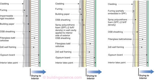

Check out the walls in Figure 3a, Figure 3b and Figure 3c. They all have “vapor barriers” on the exterior. They also can work everywhere in Canada (and the US) because of the thermal resistance outboard of the condensing surfaces. Adding interior vapor barriers to these three walls is completely unnecessary and quite frankly risky. You want these walls to be able to dry in at least one direction. They can’t dry outboard due to the material properties of the insulation boards and the spray polyurethane foam (SPF). So they need to be allowed to dry inward. No interior poly please.
Figure 3a (above left): High Performance Exterior Continuous Insulation Sheathing – This wall works everywhere. The thermal resistance of the exterior continuous insulation is climate dependent. Figure 3b (above middle): Cavity Foam Wall – This wall works everywhere. The thermal resistance of the SPF in the cavity is climate dependent. Figure 3c (above right): High Performance Exterior Spray Foam Wall – This wall works everywhere. The thermal resistance of the SPF is climate dependent.
With all of the work we have done over the past 3 decades in Canada– especially the work out of our Vancouver test hut (“BSI-058: Parthenon, Eh!”) I am pretty convinced that it is hard to beat the performance of Wall 1c and the three wall 3’s – Wall 3a, Wall 3b and Wall 3c. These walls work better than Wall 2b and Wall 2c. Other folks have come to the same conclusion. Canada Mortgage and Housing Corporation (CMHC) funded a study done by Halsall Associates and the University of Waterloo “Building Engineering Group” (BEG) that is pretty conclusive in the same regard7.

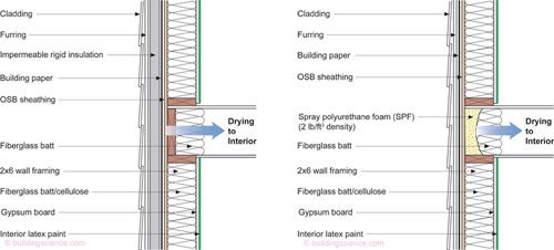

And not just the best walls, but the best assemblies. Check out Figure 4a and Figure 4b. I can’t build these rim joist assemblies in Canada without a sealed letter from an engineer or architect. You have got to be kidding.
Figure 4a (above left): Exterior Insulated Rim Joist – The thermal resistance of the exterior continuous insulation is climate dependent. Figure 4b (above right): Spray Polyurethane Foam Rim Joist - The thermal resistance of the SPF is climate dependent.
As a Canadian, I never, ever thought I would say this, but Canada should follow the American code example and provide a prescriptive path to not have to install an interior vapor barrier like sheet polyethylene. The fact that the American code language is based on Canadian work is all the more ironic. As for Minnesota and Wisconsin and their love of polyethylene? They do play hockey there. They are polite. They are humble. They are pretty much Canadian anyway. So by fixing the Canadian code Minnesota and Wisconsin would likely be fixed too.
