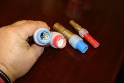

The problem of dezincification of brass water fittings was first identified in the 1950’s (2). This type of dezincification is referred to as “meringue dezincification” where the corrosion product, zinc oxide residue, blocks the fitting (Photograph 5). Although meringue dezincification was known since the 1950’s, it was pretty rare unless you had “aggressive water” – water with high levels of oxygen, water with high chloride ion content and water with high sulfate content. Hello Las Vegas. Guess what happens when we also begin to see lots and lots of brass fittings and couplings in Las Vegas?

Photograph 5: Meringue Dezincification—Note the corrosion product, zinc oxide residue, blocking the fitting.

Most of the new houses in Las Vegas with PEX piping are undergoing repairs and the associated litigation is a nightmare for everyone. In new Las Vegas homes the damage never appears on the cold side. Arrhenius again.
Las Vegas, being Las Vegas gives us some interesting twists. Remember earlier when I mentioned calcium and magnesium? These minerals typically form scale on brass fittings protecting them from dezincification. Guess what? The water heaters take them out of the water accelerating the process. Even more interesting, the elevated pH of Las Vegas water keeps the zinc oxide corrosion product at the fittings blocking the water flow. So the meringue doesn’t get flushed out of the system.
