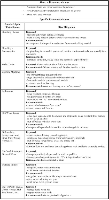

Interior Water Management Details
Table 1
Interior Water Management Measures
table_01

  • Shut-off valves should be visible and accessible.
  • A single-throw valve should be used for appliances with both hot and cold water connections.
