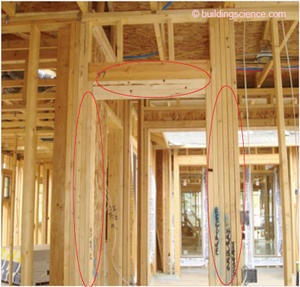

The framing above the door can be minimized by using a header of two vertical framing pieces; the vertical framing against the door can be reduced to half of the framing used.
Issue
Interior door framed with an excessive amount of wood.
All interior doors in the building framed with unnecessary extra wood.
Risks
Had Advanced Framing techniques been used an overall savings of approximately $2,000 per building would have been realized. The money could have been available to improve other building components to make them more energy efficient in addition to increasing the builder’s profit margin and improving the marketability of the product.
Required Corrections
The framing above the door can be minimized by using a header of two vertical framing pieces and the vertical wood framing against the door can be reduced to half of the framing used and incorporating Advanced Framing techniques.
