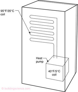

Heat energy naturally flows “downhill” from high to low temperature. A heat pump is a mechanical device that takes heat at a lower temperature and “pumps” it “uphill” to a higher temperature. For instance, a refrigerator contains a heat pump that takes heat from its interior and heats a coil at the back of the fridge. As a result the back of the fridge is much warmer than the interior of the home, and the interior is cooler. The energy cost of doing this is the electricity to run a compressor.
Figure 1: The Fridge—A common heat pump.

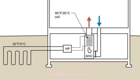

A ground source heat pump either collects heat from the ground and pumps it to a coil inside the ductwork to provide air heating, or collects heat from the same coil in the ductwork (thereby cooling the air) and rejects it to the ground. An air-source heat pump, a more mature technology used for decades, collects heat from the exterior air during the heating season and rejects heat to the exterior exactly the same as a standard air conditioner does. In some systems the heat is not collected/rejected to a coil in ductwork, but instead uses a loop of tubing in a radiant floor or ceiling application. However, the fact the outdoor heat source/sink is the air means such systems are still air-sourced heat pumps.
The terms geothermal, geoexchange™, or earth energy systems are sometimes used to describe a ground source heat pump system. However, geothermal heating is more accurately reserved for systems that tap into hot (ideally hundreds of degrees) rocks or water in the earth for heating or power production. Areas of the world with geysers and active volcanoes (notably Iceland and New Zealand) can often make good use of geothermal energy. GeoExchange™ is a newer and arguably more accurate term for the older and most accurate Ground-Source Heat Pump. The use of alternate terms provides little useful information and tends to be the product of marketing groups who have little interest in the underlying mechanics of GSHP.
Figure 3: A ground source heat pump schematic (operating in heating mode).

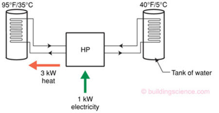

Regardless of the application, the best way to measure the efficiency of a heat pump itself is to report the amount of energy that is pumped relative to the amount that must be added to do the pumping. This ratio is called the Coefficient of Performance:
COP = quantity of heat delivered / energy required by pump
A typical efficient air conditioner has a COP of about 3.5: this means it can remove heat at a rate of about 3.5 kW while consuming about 1 kW of electrical energy.
Figure 4: Heat pump coefficient of performance (COP)

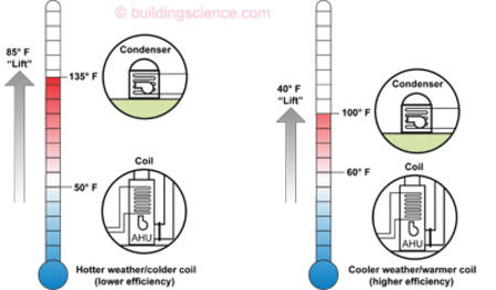

The efficiency of all heat pumps increases as the “height” that must be pumped decreases. For example, to cool a home a typical conditioner must “pump” heat from a cold “A-coil” (the finned, radiator-like device hidden in the ductwork that picks up heat from the air flowing over it) temperature of about 50 F (10 C) to a hot outdoor “condenser” temperature of about 135 F (60 C) a “height” of 85 F (50 C). If the same air conditioner only cooled the coil to 60 F, the COP would be higher and the heat pump (air conditioner) would be more efficient. If the air outdoor was cool, say 70 F, the outdoor “condenser” unit sitting next to the house would be more easily able to reject the heat to the outdoor air and so the outdoor coil might only need to be at 100 F. In this scenario, the “height to pump” would be even less, at 50 F, and the COP (efficiency) would be even higher.
Figure 5: The COP of a heat pump varies with the required temperature height that must be lifted.

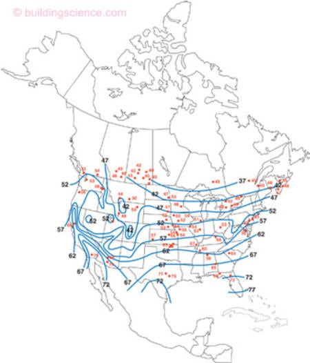

A GSHP rejects and collects its heat from the ground. Hence, the temperature of the ground greatly influences its efficiency. Using a GSHP to cool a building when the soil temperature is 60 F will be very efficient (remember the heat pump would only need to overcome a “height” of 20 F to create a 40 F coil temperature). Alas, the houses that need the most cooling are in the deep south, and in the average temperature of the soil is quite warm in this region, closer to 70 F. As the summer wears on and the GSHP pumps more heat into the ground the temperature of the soil rises well above the temperature shown on the map below and the efficiency drops. If the heat dumped into the soil during the cooling season is not extracted by the heat pump for heating during winter, or not removed by a cold winter, there is a danger that the soil temperature will rise significantly over the years.
This issue is even more significant in cold climates where the soil temperature on average is below 50 F. If a GSHP extracts heat during the winter it is quite common for the temperature of the soil around the ground loop pipes to drop to below 40 F and freezing is likely. Hence, the efficiency of the heat pump (which then needs to “lift” the 32 F ground temperature to 95 F or higher) drops.
In climate zones with moderate soil temperatures (approximately 50-65 F), the soil can provide more energy for heating in winter and a better sink for cooling in summer. For mixed-climate zones, where heating and cooling are approximately balanced, the efficiency of a GSHP system will be higher, perhaps significantly higher, than a COP of 3. In these types of applications: moderate soil temperatures, nearly balanced annual heating and cooling loads, a GSHP can be an ideal solution.
Figure 6: Map of average soil temperatures.
