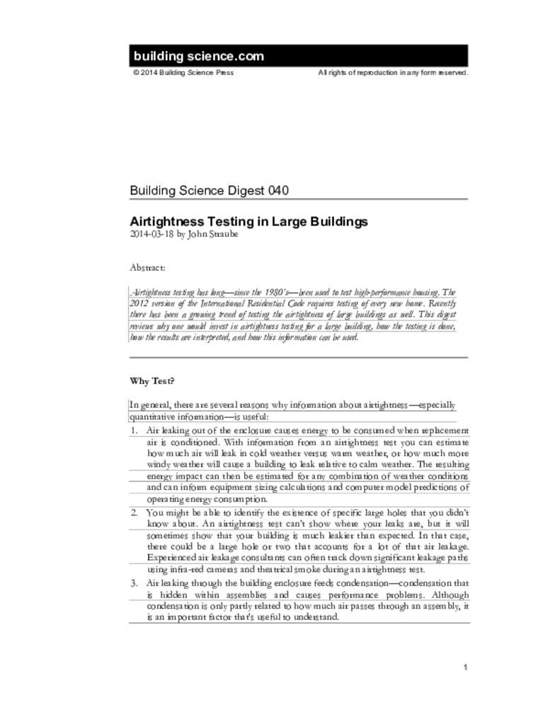

Airtightness testing has long—since the 1980’s—been used to test high-performance housing. The 2012 version of the International Residential Code requires testing of every new home. Recently there has been a growing trend of testing the airtightness of large buildings as well. This digest reviews why one would invest in airtightness testing for a large building, how the testing is done, how the results are interpreted, and how this information can be used.
Why Test?
In general, there are several reasons why information about airtightness—especially quantitative information—is useful:
- Air leaking out of the enclosure causes energy to be consumed when replacement air is conditioned. With information from an airtightness test you can estimate how much air will leak in cold weather versus warm weather, or how much more windy weather will cause a building to leak relative to calm weather. The resulting energy impact can then be estimated for any combination of weather conditions and can inform equipment sizing calculations and computer model predictions of operating energy consumption.
- You might be able to identify the existence of specific large holes that you didn’t know about. An airtightness test can’t show where your leaks are, but it will sometimes show that your building is much leakier than expected. In that case, there could be a large hole or two that accounts for a lot of that air leakage. Experienced air leakage consultants can often track down significant leakage paths using infra-red cameras and theatrical smoke during an airtightness test.
- Air leaking through the building enclosure feeds condensation—condensation that is hidden within assemblies and causes performance problems. Although condensation is only partly related to how much air passes through an assembly, it is an important factor that's useful to understand.
- Air leakage can bring polluted outdoor air into a building from, for example, a parking garage, a dumpster, or an exhaust vent. Knowing how much air goes through your building enclosure will help identify how much risk there is of bringing in outdoor pollutants. Once you know, you can set targets to minimize the risk.
The energy cost of air leakage is the least-studied aspect of airtightness in larger buildings. It is sometimes assumed that larger buildings, especially commercial buildings, are usually already sufficiently airtight that improvements would yield little benefit. However, the limited data that exists does not support this assumption. For example, Emmerich, McDowell and Anis (2005) used a building energy simulation program to predict potential annual heating and energy cost savings of 2% to 36%, with the largest savings occurring in heating-dominated climates in office and retail buildings (compared to a four-story multi-unit residential building). In climates with humid summers, air leakage can add a very significant latent load to the air conditioning equipment, both increasing energy use and resulting in less comfortable interior conditions.
Given the potential for energy savings, improved understanding of HVAC equipment loads and the management of IAQ and condensation risks, it makes increasing sense to test buildings of all sizes for airtightness and to take steps to address any air leakage.

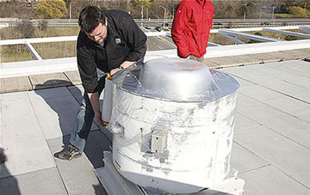

For larger buildings, that is, with a floor area of over about 10, 000 ft2 (929m2), this test method usually requires numerous co-ordinated blower doors running at the same time. In some cases, large mobile fans requiring trailers and external power sources have been used. In all cases, large or small, a building must be prepared for testing beforehand by blocking intentional openings such as HVAC intake and exhaust grills, kitchen and bathroom exhaust fans, relief dampers, etc. (Figure 2). Sealing intentional openings is usually the part of the testing that takes the most time and effort.
Figure 2: Sealing an intentional opening on the roof of a building during test set-up.

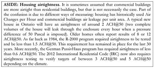

In single family residential construction, it has been customary to normalize by building volume. The measured airflow rate at a pressure difference of 50 Pa is converted to air changes per hour (ACH). Air changes per hour is simply the volume of air leaked per hour, divided by the volume of the building. The test data is then reported as a number in “ACH@50”.
Air changes per hour is also sometimes used to report air leakage for commercial and larger-scale buildings. Due to the more variable surface-to-volume ratios of the different geometries of these buildings it is more common, and technically superior, to provide the leakage rate at a specific pressure in terms of flow per unit area; in other words, as cubic feet per minute per square foot (cfm/ft2) or litres per second per square metre (lps/m2) of building enclosure area. “Area” here means the total area of six sides of the cube, i.e, the four walls and roof and slab, so all sides that are exposed to the outdoors are part of this equation. Test results are reported in “lps/m2@75Pa” or “cfm/ft2@0.3 in wc”.

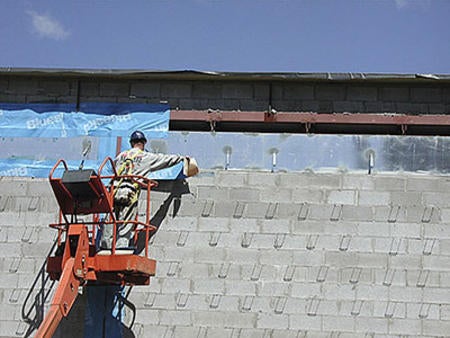

Airtightness targets are useful during the design process for new buildings as well as retrofits—they establish quantitative expectations for a very important aspect of building enclosure performance and provide a key input into the mechanical designer’s load and energy calculations. Airtightness tests should therefore be an important part of the construction process—they provide confirmation that airtightness targets are met and, if timed properly, afford the opportunity to address problems before it is too late.
Figure 5. Achieving airtightness requires attention to detail at all transitions and penetrations from design through construction.
Airtightness testing can also be used diagnostically. For new construction, you should typically do a test as early as possible in the construction process so that if the building fails, remedial work can be undertaken to find the cause and fix it. Similarly, if you are about to do a major energy efficiency retrofit—replace windows, add insulation or take other substantive steps—it is usually advisable to do a test before you get too far into the design of the retrofit. Testing should be done as part of the assessment of the existing building, to gain an understanding of how leaky the building is, so that you can decide how much effort should be spent on airtightening versus how much effort should be spent on, for example, insulation or new windows.
