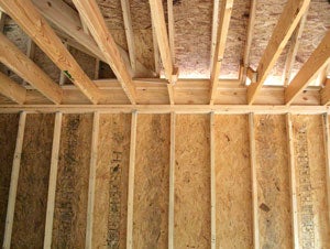

Air Sealing: Taped Huber ZIP System® sheathing; low expanding foam sealant around windows doors, penetrations and base plates
Huber ZIP System®

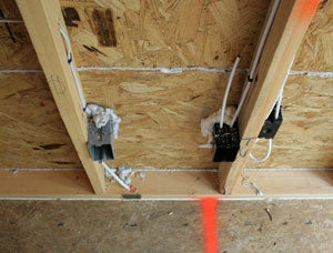

Air sealing electrical boxes

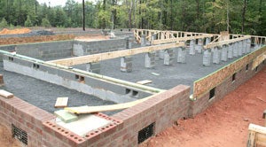

Foundation: Vented unconditioned crawlspace
Vented, unconditioned crawlspace

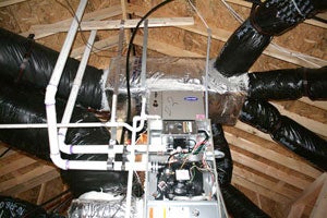

Ducts: R-6 flex ducts with mastic sealed joints
Flex ducts in attic
