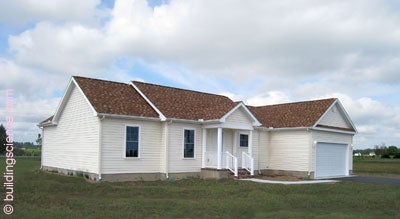

Sandstone is a 49-home subdivision located in Ellendale, DE. The project is Colter Construction’s first entry into community-scale development. The homes are intended to be attractive to the first-time homeowner, and to empty nesters, two strong markets in the region. The company has considerable experience building energy efficient custom homes in Sussex County.
Founder and owner Terrance Babbie contacted BSC in May of 2009 for help in bringing his construction practices up to the state of the art. Terrance was already familiar with much of BSC’s published materials, and works with subcontractors who are also accustomed to standard energy measures in the custom market. This experience was invaluable in rapidly implementing BSC’s recommendations for airtightness, insulating sheathing, duct layout, and other efficiency measures.
The homes are single-family detached residences of 1200 to 2000 ft2 with unvented crawlspaces. The community is located in DOE Climate Zone 4A, a mixed humid climate. Humidity control and mechanical efficiency, for both heating and cooling, were of special concern.
The Building America energy consumption reduction goals (minimum 40% source energy consumption reduction compared to the 1990’s Benchmark construction) were exceeded for the community. The homes were modeled at around 44% savings, an exceptional performance in this market.

Description: 1,280 ft2 one-story, three bedroom, two bath single family home
Completion Date: September 2009
Estimated Annual Energy Savings: 44% energy use reduction compared to the Building America benchmark
