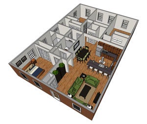

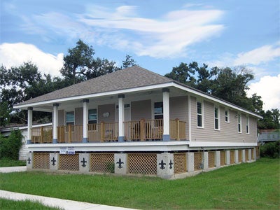

The Green Dream 2 is a single-family home built on the site of a hurricane-damaged house that stood for 3 years before being demolished by the city of New Orleans. Staff and students from Portland Community College met the homeowner and his family on a trip to New Orleans and wanted to help them by building a new home; one that would be durable, healthy, comfortable, energy-efficient and affordable. Portland Community College connected the homeowner with Catholic Charities Operation Helping Hands who, in turn, asked BSC and the LSU AgCenter to be a part of the team.

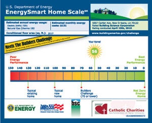

Architects and engineers at BSC created the plans and specifications for the 4-bedroom, 2-full bath, 1,944 ft2 house. As designed, the home will achieve a 57% energy use reduction when compared to the Building America Benchmark house. This 57% energy use reduction is equal to a HERS score of 56 and an estimated $2,029 annual utility bill cost savings to the homeowner.
Not only is the Green Dream 2 energy-efficient, but it is durable as well. Designed to withstand 130 mph winds and built with flood-recoverable materials, the home will serve as an example of high-performance construction in a hot-humid climate.

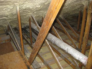

All ductwork and mechanical equipment for Green Dream 2 is located in the unvented conditioned attic. Ductwork is sealed with mastic and caulked to ceiling drywall to prevent duct leakage and ensure air flows to rooms in the house are as designed to create a comfortable living environment.
In addition to heating, cooling and ventilation, Green Dream 2 is also equipped with supplemental dehumidification, a dehumidifier located in the attic with dedicated ductwork pulling air from the living space and supplying dehumidified air to the supply plenum.
Roof Assembly: Truss-framed unvented attic with R-30 roof insulation: 7” medium-density (0.8 pcf) open cell spray foam below roof sheathing, 5/8” treated plywood roof sheathing, fully-adhered roof membrane, high wind-rated asphalt shingles installed over the trusses, ½” paperless drywall installed below trusses.
Unvented attic with open cell spray foam

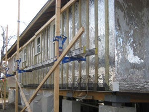

Wall Assembly: 2x4 treated walls at 16” o.c. with R-13 wall insulation: stud bays left open, ½” treated plywood, housewrap, 2” foil-faced polyisocyanurate insulating sheathing, ¾” treated furring strips and fiber cement siding installed on outside face of studs, ½” paperless drywall installed on inside face of studs.
Foil-faced polyisocyanurate insulating sheathing

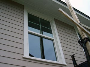

Window Specifications: Showcase Custom Vinyl Windows and Doors single-hung, double pane, spectrally selective, impact rated Low-E: U=0.40, SHGC=0.21.

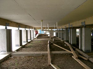

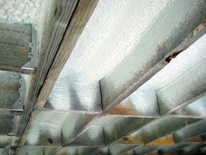

Foundation and Floor Assembly: Wood pile, concrete grade beam and adjustable pier foundation, treated joist-framed floor on treated sill beam with R-15 floor insulation: 2.5” high-density (2.0 pcf) closed cell spray foam between floor joists, ½” fiber cement protection board installed below floor joists.

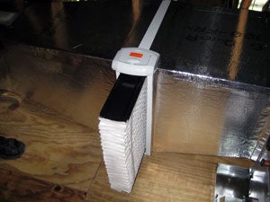

Heating, Cooling and Dehumidification: 9.0 HSPF/15.5 SEER air source heat pump split system with supplemental whole house dehumidification. Interior unit installed in conditioned attic with MERV 13 filter.
Ventilation: Central fan-integrated with supply only ventilation system controlled with built-in controls in dehumidifier. Outside air ducted to the return side of the air handler including both motorized and manual dampers.

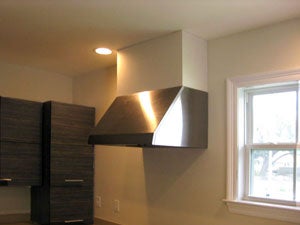

Local Exhaust Ventilation: Intermittent spot exhaust provided in bathrooms and kitchen.
Space Conditioning Distribution: Air handler with sheet metal plenums and R-6 duct board supply trunk and R-6 flex duct run-outs installed in conditioned space. Ducted central return, dehumidifier return and transfer grilles above bedroom doors.
Duct board supply trunk and run-outs

Construction began in June 2009 with the driving of the wood piles for the foundation. Concrete grade beams were poured over the piles and telescoping concrete piers were set on the grade beams. On top of this foundation, both borate pressure treated and ACQ pressure treated wood was used to frame the house and porches. Throughout the construction, a Catholic Charities site supervisor instructed volunteers, participated in weekly conference calls and worked through details with the project team. This level of commitment and coordination ensured that critical design details were carried out in the field.
Once the housewrap was in place on the treated plywood, the project team held a window installation demonstration for volunteers and industry professionals. The window installation sequence from the drawing set was followed step by step as project team members assisted volunteers in installing Green Dream 2’s sixteen windows.
